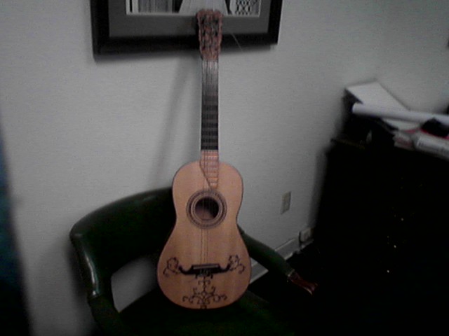

For fun, here is a pic of a Juan Pages 1783 that Fred (my friend) built.
Not a good picture.  Took it with my phone.  Guitar needs a tuning peg and new strings plus some cleaning up.  I have played it, and it sounds great.
